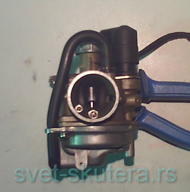

...evo kako ide na dell 17.5 ...
Ova dva izvoda koja su obelezena kao oduske za gorivo mogu da budu u nekim verzijama i za grejanje karba[kod LC]...
Evo i malo slika mikunija 16[kopija] koji se ugradjuje na skoro sve 2t kineze ..+kako podesti smesu i
ler gas..

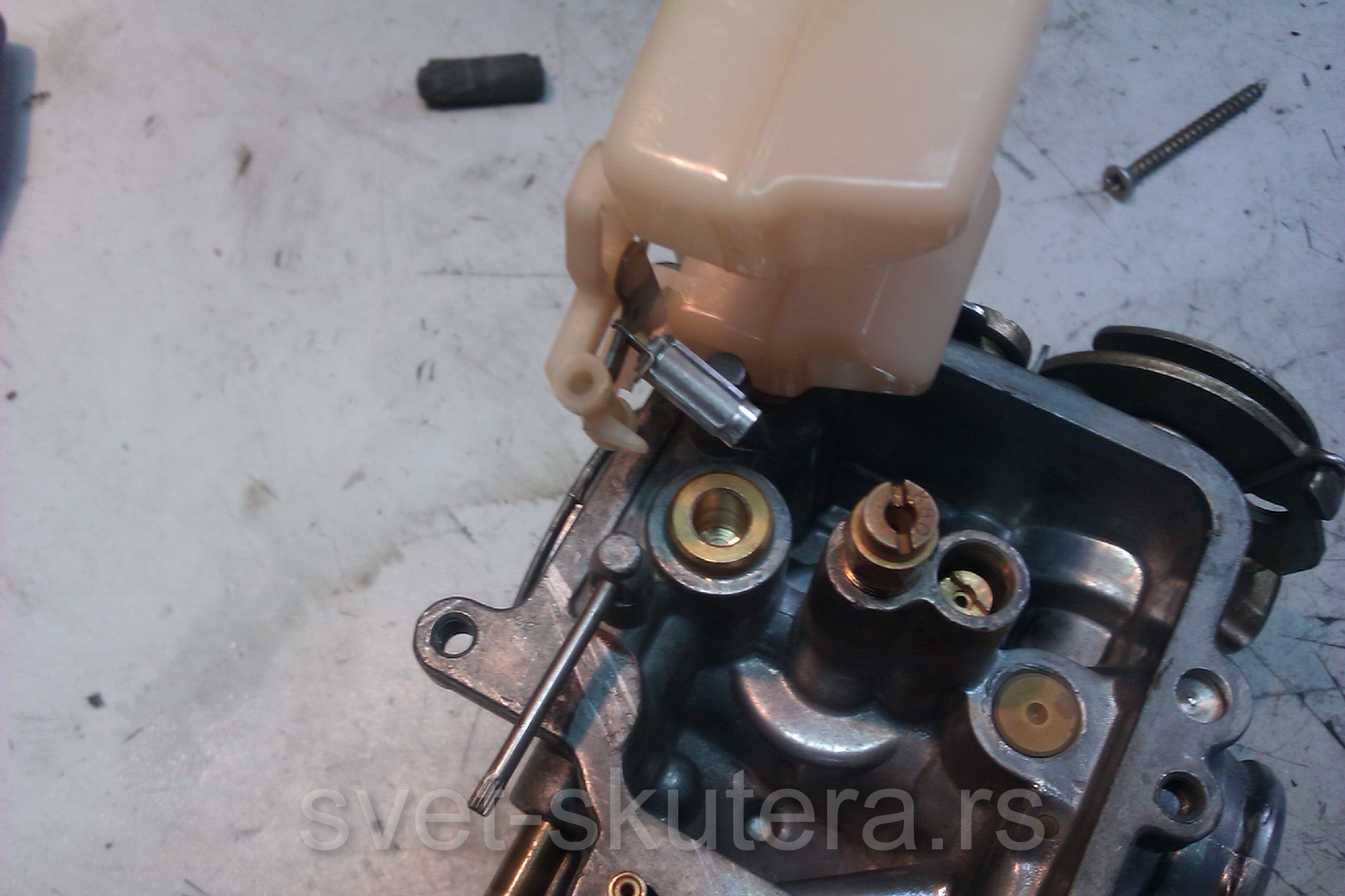

http://49ccscoot.com/carbclean.html
Carburetor Cleaning
I'm no carburetor expert and this is a very basic cleaning.
I start by removing the 2 phillips scres that hold the auto-enrichener on.
Once it is off, I make sure everything can move freely and clean it off with a little carb cleaner. Carb cleaner harms some plastic so you may want to just get the metal parts with it and wipe the rest.

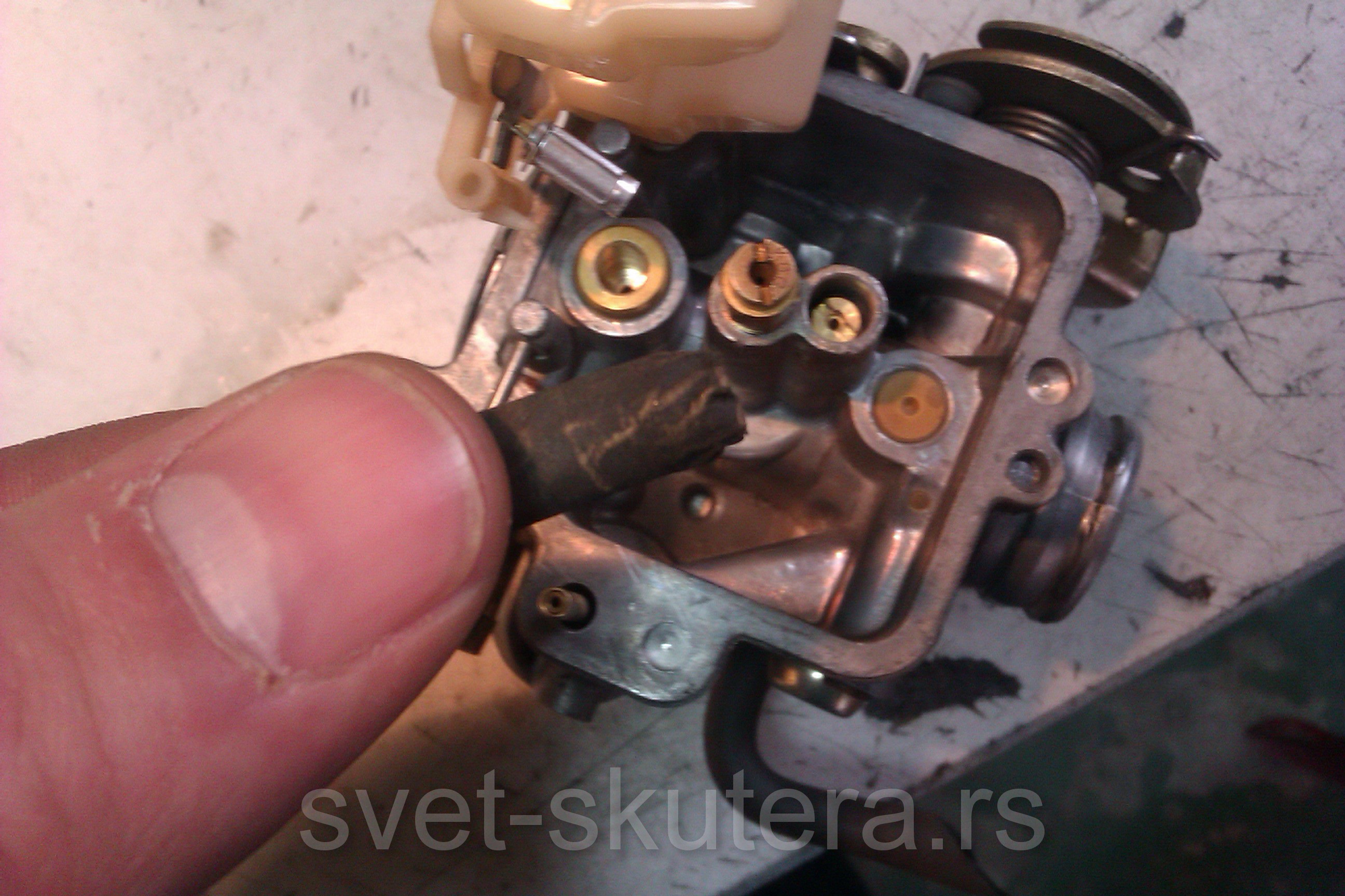

I now remove the clamp and float bowl drain hose. Clean it off and be sure it is not cracked or torn. Replace if necessary.
Now I spray the carb with carb cleaner to get rid of a lot of the grease and gunk.
Remove the carb top. There is a gasket under it, inspect that and replace if it is damaged.
Take out the spring and throttle valve assembly as well.
Now I take out the 4 screws holding the float bowl in place.
My bowl has some buildup, so I spray some carb cleaner in the bowl and let it sit.

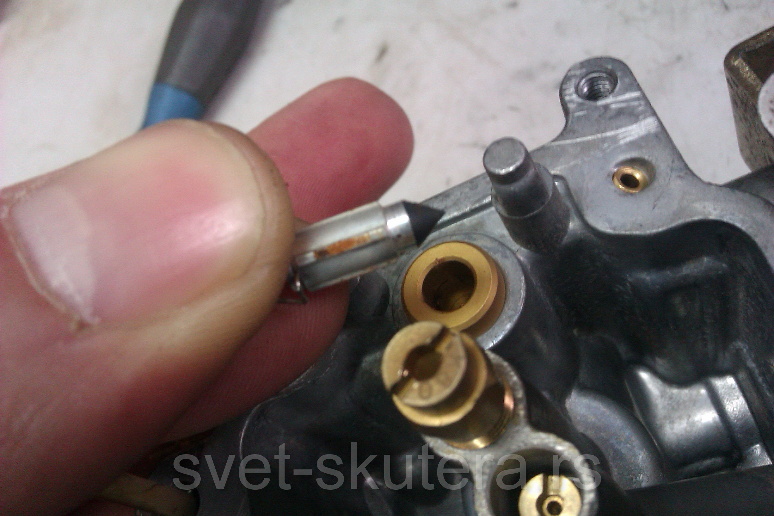

Now I take the pin out and remove the float.
Be careful not to lose the little float needle.
Remove the float bowl gasket and spray the carb out with carb cleaner.
Make sure the gasket looks healthy, replace if necessary.

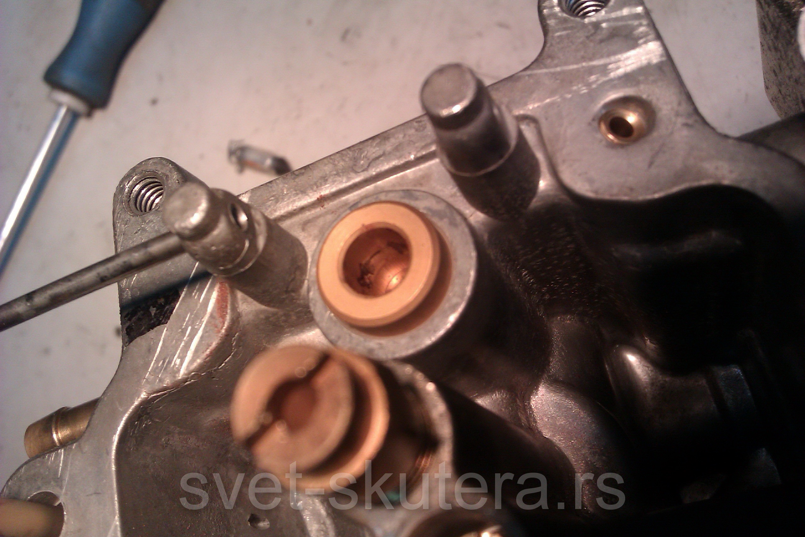

I unscrewed the main jet to make sure it isn't clogged or dirty and sprayed it out. I then reinstalled it.
Holding jets up to a light will help you tell if it is clogged.
I then removed the idle speed screw and cleaned the screw and passage, then reinstalled. You may want to see how many turns it takes to get the idle screw all the way in, and write that down. When reinstalling, turn the screw all the way in then back it out that number of turns.
Now I do the same with the mixture screw.

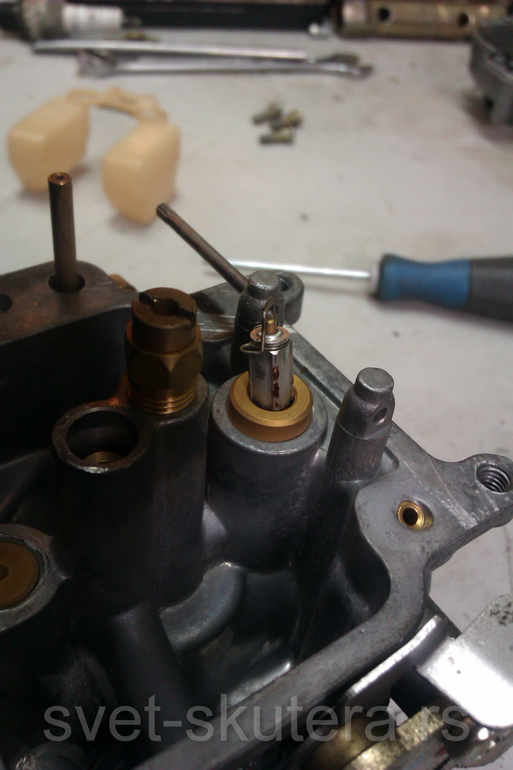

Now I remove the clip that holds jet needle and it's clip in the throttle valve.
Clean all of these parts then reassemble. Be sure the M clip doesn't block the groove in the throttle valve when you put it back together.
Now I let all of this sit overnight so the carb cleaner can work it's magic on the bowl.
The carb cleaner has done it's work so I dump it out and wipe the bowl out.
I remove the drain screw and clean it and the opening with carb cleaner, then reinstall the screw.
Put the bowl gasket back in place, making sure it is properly seated.

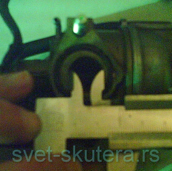

Reinstall the float and float needle. Now is a good time to check float height by measuring from the bottom of the carb to the bottom of the float (which are both kinda the tops since it's held upside down). Vento wants a 12-14mm float height.
Reinstall the float bowl.
Now I put the throttle valve back in the carburetor. Notice there is a long groove and a small ramp on the throttle valve. The ramp is for your idle speed screw to contact, so aim int toward the idle speed scew when installing.
Put the spring back in.
Reinstall the carb top.
Put the auto-enrichener back on.
In my case, make sure the cap for the oil injection port is in good shape.
Reattach the float bowl drain hose and clamp.
[center]

Rade& said:
unutrašnja mera ?
#8
Posted 05 January 2011 - 17:42
Rade& said:
Rade druže, svaki otvor koji je okrugao mora imati neki prečnik, a taj prečnik je prečnik difuzora, ako sa strane filtera ima duguljasti otvor onda je recimo taj otvor 20x12mm koji je površinom recipročan otvoru okruglog promera od 17mm, meri se okrugli otvor koji ide na cilindar... tj njegov prečnik,, nije bitno kakav ja sa strane filtera
#9
Posted 05 January 2011 - 17:43
Rade& said:
evo slučaj kod mene Keihin PB170, 17mm karburator sa Kymco Super 9 fabrički
17mm
12x20mm
#10
Posted 05 January 2011 - 17:44
cvele19 said:
a kod klipica 14 puta 18...
Rade& said:
površina otvora je
16mm r^2x PI=201mm^2
14x18mm = 252mm^2 manje oni obli krajevi elipse biće isto 201mm^2
dakle kod malih karburatora je urađen pravougaono elipsasti promer kod klipića i njegova površina otvorenosti mora biti ista kao i površina otvora krarburatora odnosno prečnika pravilnog kruga
sad to što se širi prema prirubnici (pričam o prirubnici prema usisnoj grani cilindra) nema veze trbealo bi da je prečnik kruga na samoj prirubnici prečnik difuzora karburatora, ako to nije tako, meni uopšte nema logike da se otvor difuzora karburatora (kad kažem difuzor mislim na otvor karburatora, a ne na usisni konus pošto i njega nazivamo difuzor) širi na delu prema cilindru...
kolikog prečnika je taj gurtner ? da nije 15mm ?
#11
Posted 05 January 2011 - 17:45
Rade& said:
Na 2004. godistu fabricki je Dellorto PHVA ID 17,5mm.
Kupi neki serijski 12mm i resen problem Bice manja potrosnja, ali sigurno i nesto manja snaga..
#12
11,5 x 14,5mm = 166.75 mm^2
a površina karburatora sa
12 difuzorom je 6^2 x PI = 113.09 mm^2
13 difuzorom je 6.5^2 x PI = 132.72 mm^2
14 difuzorom je 7^2 x PI = 153.93 mm^2
15 difuzorom je 7.5^2 x PI = 176.70 mm^2
dakle preko površine možemo zaključiti koji je difuzor, naravno moramo odbiti grešku, jer to kod klipića nije pravougaoni presek nego elipsasti, pa površine krajeva koji ne pripadaju merama takvog pravouganika treba odbiti...
opet daleko je veći od 12mm, moguće je da je na sastavu malo veći, mada ako uzmeš šubler i izmeriš unutrašnji prečnik kruga, dakle mesto gde je elpisa prešla u pravilan krug, ne bi smelo biti veće stvarnog prečnika difuzora karburatora, jer se stvara nepotrebno vrtloženje...
aj ako ti nije teško proveri još jednom prečnik untrašnje mere gde je pravilan krug...

zoksi said:
Rade& said:
Pravilan krug je samo na izlazu prema prirubnici (17mm). Sve ostalo je pod nekim skosenjem prema klipicu.
Ma 12 - 12,5mm je sto posto
A i na sajtu kazu da je 12mm...http://www.scooter-prosports.com/art-36300...it=mehr+Details
Pitin karburator je sigurno veci. I nije kao moj ovaj na srafove - njegov ima drugaciji prihvat...
#14
Posted 05 January 2011 - 17:46
Evo primera kako može da se izračuna prečnik odnosno difuzor ako imamo otisak otvora klipića...
1. Prvo na neki papir koji je primernih dimenzija da uđe u rupu otvora klipića, postavimo papir sa unutrašnje strane otvora gde inače klipić klizi i nekim flomasterom ili hemijskom ocrtamo ivice po papiru. Mora se paziti da papir ne klizi, a otisak može da se uradi jednostavno samo pritiskom tela hemijske olovke ne crtanjem..
2. kada papir izvadite uočićete otisak, koji je u Mikuni 16 slučaju dimenzija 17,5mm visine i 14mm širine..
3. Da ne bi pogrešili otisak širine je pod uglom klipića i može se premeriti jedino ako je papir ponovo savijen oko tela nekog flomastera koji je iste širine.. Ovako izlazi širina otvora 12,5mm
4. Sada na papiru treba ucrtati pravougaonik ali te mere koja je stvarne širine pod uglom klipića a ne otiska, prva slika..
5. Kasnije treba dodati jednakokrake pravougle trouglove koji svojom dimenzijom zauzimaju naveći deo prostora u koji ne pokriva stvarni otvor u odnosu na mere pravougaonika tih dimenzija
Ostaje da izračunamo površine...
- površina pravougaonika je P=axb dakle 12,5x17mm = 218.75mm^2
- uctani pravougli trouglovi umaju katete dužie 2,5mm, pa je njihova površina P= a^2/2 dakle (2,5^2)/2= 3,125 mm^2
- imamo 4 površine takvih trouglova to je 4x3,125mm^2 = 12,5mm^2
- površina elipse biće površina pravouganogo otvora manje 4 površine trouglova dakle P= 218,75-12,5 = 206.25mm^2
- znamo da je površina difuzora odnosno kruga P=r^2 x PI gde je r poluprečnik difuzora na kvadrat puta Pitagorin broj 3,1415
ako ovu formulu preinačimo u proračun nepoznate gde imamo P izgledaće ovako
..............P
r^2 = -------- odnosno
.............PI
..................P
r= SQR ---------- gde je SQR kvadratni koren
.................PI
.................206,25
r= SQR -------------
.................3,1415
r= SQR 65,6533 = 8,10mm gde je prečnik dva puta poluprečnik
R=2xr = 2x8,10
R=16,2mm
Dakle pogrešili smo u računu 0,2mm, greške se javljaju kod oduzimanja površina jednakokrakim trouglovima, jer ostaje prostor koji oni ne pokrivaju i prostor gde prelaze u ivice elpise..Možda je moglo da se radi sa pravouglim trouglovima različitih dužina kateta.... Svakako je tačnije nego da radimo samo sa površinom pravouganog otvora, a postoji i preciznija postavka ove površine, meni je palo na pamet da ovo uradim ovako...
U pravu ste Mikuni 16 izlazi na priključku sa prirubnicom na 18,5mm dakle širi se pa u ovom slučaju to nije pravilo za određivanje prečnika odnosno difuzora karburatora...

Reč je o 4T karburatoru Keihin 18 sa membranom za GY6 motore, ali isto može da se desi i na drugim karburatorima... Zadnjih par godina uglavnom proveravamo nivo goriva koje plovak pušta u lonče i metodom duvanja vazduha preko malenog creva i manuelno pomeranjem plovka gledamo gde je nivo i koliko otvara i zatvara plovak dovod goriva... U ovom slučaju gorivo nije proticalo, jer je ventil bio zapečen u kućištu, u razgovoru sa vlasnikom imam informaciju da je motor nekada išao nekada nije, nekada nije mogao da upali itd... rezultat je bio i mrtav akumulator i slomljeno kućište zupčanika kurble...
evo kako izgleda skrama koja se uhvatila , i jednostavno 600 šmirglom može da se počisti... ovaj detalj mislim da svima može biti bitan, obzirom kakvo gorivo u zadnje vreme kupujemo...
